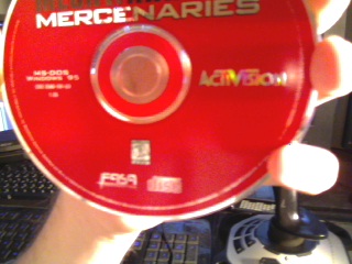

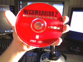

I also believe my CD is in that list, although I have no way of knowing which one it is. All I know is its a red cd with black title on it. I think its the semi function 2000 one because I remember it working on XP at one time I think. If not it is either the D3d rip off or 3dfx ripoff. It is not one of the single player only ones, I know that. If you want I could post the CD contents on an FTP for examination, don't know if that is against mech2.org's policy or not though.

Okay, didn't work.
I copied your MechVM that was in the zip and pasted it over the other one that was in my mechvm folder(a fresh install of MechVM anyway.)
Tried to install, it came up with 31st battlepack again. Maybe me taking a picture of the CD will help out? Posting it in attachments.
I think it can install the DOS version and the windows version, now that I look closer at the CD.

- Closer Pic of CD
- Picture 4.jpg (30.13 KiB) Viewed 16429 times
- Pic of CD
- Picture 1.jpg (30.79 KiB) Viewed 16429 times
