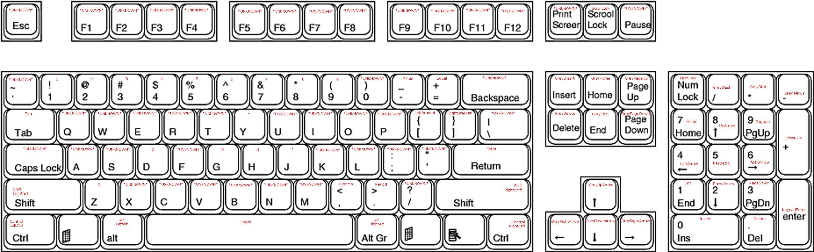

Refer to the "INPUT" image below for the list of key bindings. The red text is what you type in to designate that key, the Shift/ Ctrl/Alt keys each have two designations, the top one is for any Shift/Alt/Ctrl key pressed, and the bottom is to define it as left or right.
Anything that is "*UNKNOWN*" I could not find the Input for, or it just did not work when I tried it. if you know what it is or how to get it working post it up so everyone else will know too.

I'm happy to report that to my knowledge all keys marked UNKNOWN on the keyboard diagram are accessible as *X where X is the key
I'm successfully using:
Code: Select all
throttle_plus {
	+ keyboard *W
	- keyboard Shift
throttle_minus {
	+ keyboard *S
	- keyboard Shift
torso_tilt {
   - mouse       Up/Down
torso_pan {
   + mouse       Left/Right
# Turning, on the keypad arrows
legs_pan_minus {
	+ keyboard	 *A
legs_pan_plus {
	+ keyboard	 D
jumpjet_enabled {
	+ keyboard	 Space
for a rudimentary WASD setup. Note that since D is noted on the keyboard map image, *D does NOT work. I'll be updating this as I go, but it should form an Ok basis for people wanting to play with WASD. I'm going to modify it to be as much like Mechwarrior Online as I can since that's what I'm used to lately.
I discovered this by cracking open a number of files in a hex editor and searching for "GreyArrowUp" since I figured that would be a fairly unique string. I found it in GIDDI/KEYBOARD.DLL and it is surrounded with all valid key names. Other interesting keys are there like *One through *Nine, *Backspace *F1 through *F11 and many more.
