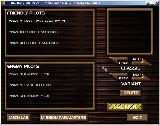

Col.Kell wrote:Hmm... I never thought of the in-game-lab thing. But I am mainly the guy who mods the PRJ, not the Shell. I am learning a little bit, but I'd like to do something like that. Hopefully if I can figure things out I can add KAM chassis selection into the shell.
As best I can tell, this information is hard coded into the shell executable (MW2SHELL.EXE), which will make altering it a major pain :-( I've tested this in DOS Mercs 1.06 by blanking out an entry in the mech table (located at offset 0xda13f) - when the game is running, the mech name & video disappear from the mech lab (although the tonnage still appears, which means there is additional information elsewhere in the EXE) and attempting to launch the sim with the blanked out mech will cause the game to crash. You could probably replace existing entries without much trouble, but adding extra entries would require some serious EXE hacking :-(
The bit that really confuses me though is that most of this data also occurs in the MTAB/MECH.MTB entry of the MW2.PRJ file - why the shell doesn't use this is beyond me :?

Skyfaller wrote:The shell might take the mech tonnage from byte 0 in the MEK files.
For the actual mech editor portion I would say you're right, but for the mech selection screen I think it's in the EXE. Check these out:
The table I mentioned before (very similar to MECH.MTB) contains four names for the mech: one is 2 characters long, one is 3 characters long, one is up to 8 characters and the fourth is the full name. Not sure what the 2char name is for, but the 3char one seems to choose the SMK video & MEK files, the 8char name chooses the BWD for the mech and the full name is displayed to the user. In the first screen shot I've erased the 3char name (hence the missing video) - I've also removed all of the Warhawk MEK files from the project file. In the second shot I've erased the whole record (all four names) - the tonnage still appears.
I'm guessing there's some other table elsewhere in the EXE with mech records, each with the tonnage, a pointer to the name table, and probably other details :?:

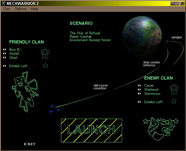

Col.Kell wrote:So far I have made 6 mechs: I call them "Boro", "Correr", "Ghast", "Sirus", "Katana", and "Auger".
Please give us some pix and specs!

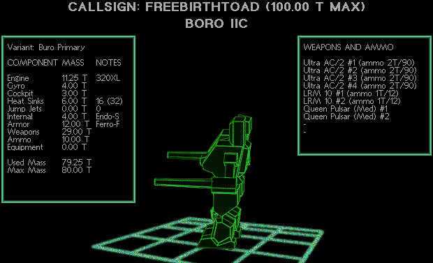

Added one more mech; "Morbit". And there ya have specs for at least the Boro ;) The only things I need left to do are to make MEK files for all the mechs, and fix the insignia on two of the mechs, and then they will be released.
