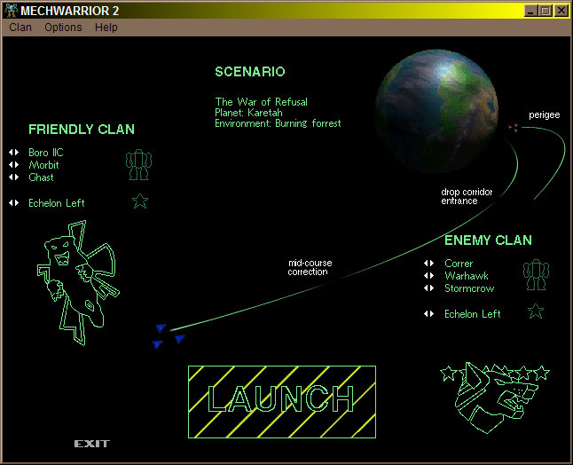

Col.Kell wrote:So far I have made 6 mechs: I call them "Boro", "Correr", "Ghast", "Sirus", "Katana", and "Auger".
Please give us some pix and specs!

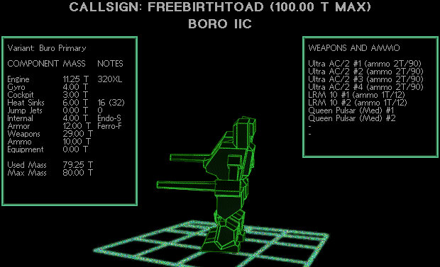

Added one more mech; "Morbit". And there ya have specs for at least the Boro ;) The only things I need left to do are to make MEK files for all the mechs, and fix the insignia on two of the mechs, and then they will be released.
