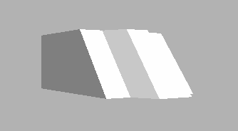

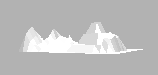

I'm trying to use the knowledge about how texturing works in MW2 to create new WTB files (objects in the MW2 sim). Unfortunately, without success.
Here's how far I got: I have created two .OBJ test files and written an algorithm to convert them to .WTB's. I can display them in MechVM, but not in the MW2 sim. So I started doing some experiments: I took other WTB files and edited them. The meaning of byte 4 to 16 in this file type is unclear at this time. Adding one to one byte and subtracting one from the next byte in this part of the header apparently leave the file intact. All other changes I made make the WTB invisible. I'll attach the two files I created so you can experiment with them yourselves (plural in case someone else besides Kell is interested ...

- A simple Shadowcat torso for testing
- scat.png (1.16 KiB) Viewed 89796 times
- A simple mountain model for testing
- mnt.png (2.54 KiB) Viewed 89799 times
