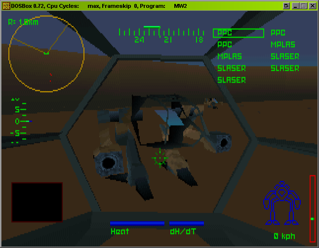

Something worth posting,
all that .WTB geometry that begins with the title **5_HEAD.WTB, (e.g., TW5_HEAD for Timberwolf, SC5_HEAD for Stormcrow...) all mech HEADs that have that "5" in the title, those are the shapes of what you see INSIDE the mech. So if you ever wanted a different interior frame, just go into the mech BWD and you can change the tag that links to the mech's **5_HEAD, and change the tag to a different **5_HEAD.

Re: Misc. Discoveries
ohhh.... so this is where you already posted this pix... ok. :P
