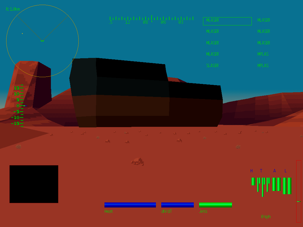

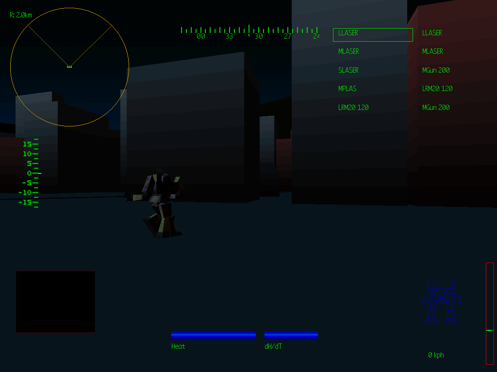

Similar to my "Build-A-Mech" thread, I am dedicating a thread all to custom levels.
With a little help from MechVM, I was able to pull this off.
Behold! JumboDevin!
This Battlemaster actually got lost in this map! lol!
...If Skyfaller is reading this, which he may be, let him tell me what the .BWD is for the Devin map, so I can post this wierd but cool map for people to play.
If anyone want's to try this themselves, contact me (or maybe Skyfaller) via the post. I'll gladly help out.

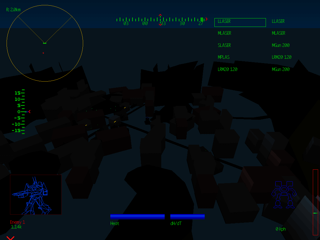

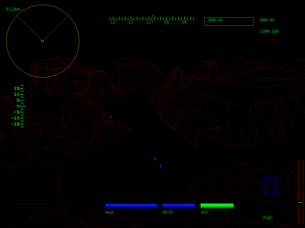

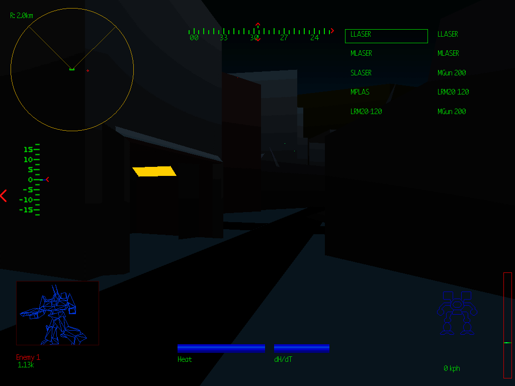

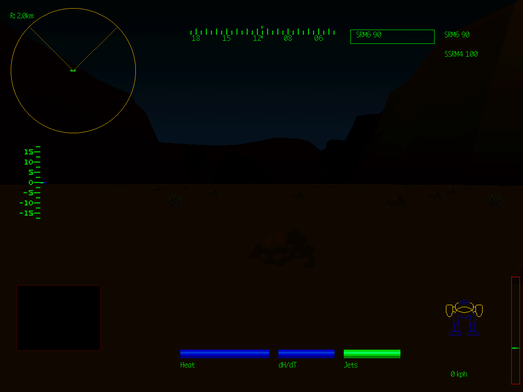

Here is a new level I made this one I think works better and is less awkward than JumboDevin.
This was made from the map "Goat Path" from the skirmishes on MW2:31cc. I thought this map looked a lot like something that belonged in planet Gravanhage in MW2:Mercs, I replaced two of the mesas with a mountain pass piece and the wrecked ship hull. It looks like it was once a network of rivers.
Here is a view from the Wolf level "Scorching Sand"
Here is a very long 'T' shaped gorge in the map.
