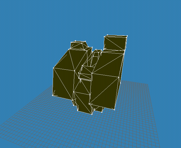

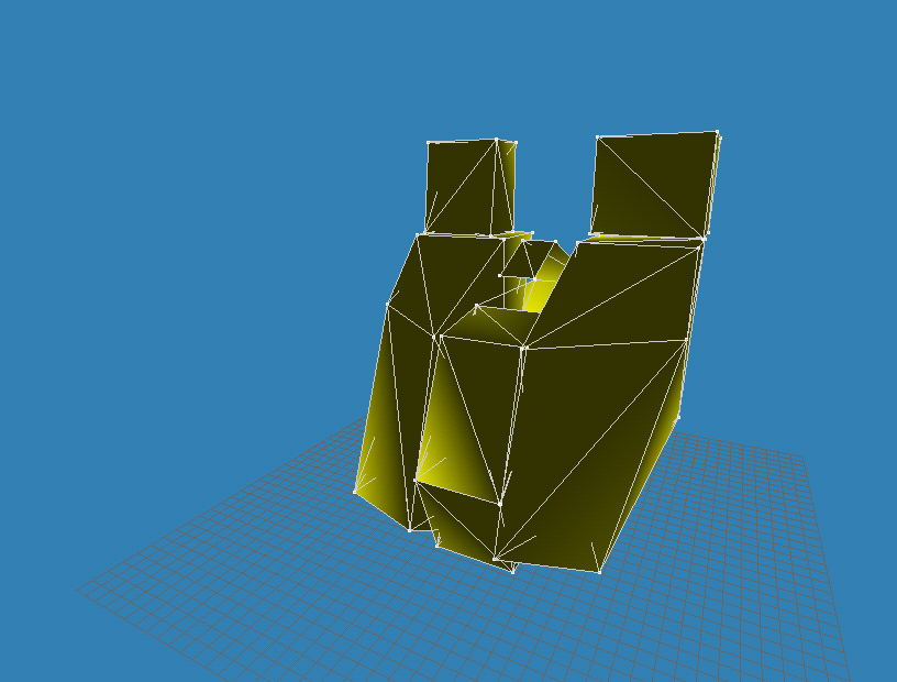

I have edited a Hellbringer head on "3D Milkshape",
Yeah, it may look dumb, but it could mean a breakthrough if we can export OBJs back to WTB. Do you by any chance, Skyfaller, have or know if this can be done?

Thanks for the info Skyfaller, I have noticed in a hex editor that some characters define lines, some define vercities, and others info on the XYZ grid (if there are ANY unconnected lines or vercities, the game will crash. I'm going to look at hex editings of WTBs on mechvm to see any changes done.)
Even if exporting to WTB cannot be done, I've still got new mods (to soon be posted in Screenshots) that you may find very interesting. :D
