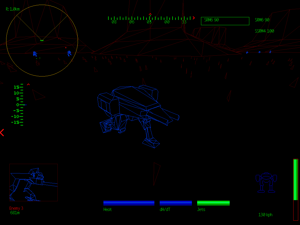

My first mech, a nova body and cockpit with a kitfox head.

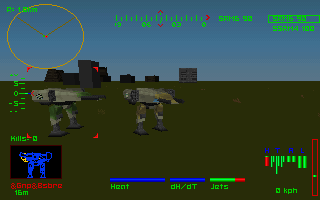

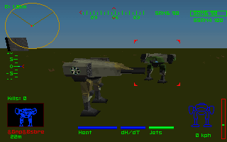

my second mech, a jenner body with a tarantula head. (you can't hit the cockpit because it is hidden inside the mech! So now you are somewhat safer.)
HOW I DID THIS
(for example), the mech in the second picture I copied the data of TA1_HEAD.WTB (the info that makes a tarantula head), and I pasted it over JN1_HEAD.WTB, and then I got a jenner with a tarantula head!
MAKE SURE YOU DON'T ADD OR SUBTRACT ANY CHARACTERS IN THE PRJ!!!!! Make sure you have INSERT mode on. And if you are replacing (e.g.:) 108A number of characters, make sure you are highliting 108A number of characters, THEY MUST BE THE SAME AMMOUNT! If you are trying to replace a mech piece of greater data size with that of a smaller one, that is okay, fit all of what you can over the existing data, IT WON'T WORK THE OTHER WAY AROUND!
It's easy once you get the hang of it. :lol:
You need a hexedecimal editor (I recommend HexEdit 3.2 due to it's powerful capabilites and easy to use tools), and you need to know how to search for hex numbers using the "FIND HEX" ability too.
This is a fun activity! If you have questions, or want me to clarify some things, shoot me a response. I'll answer. :)

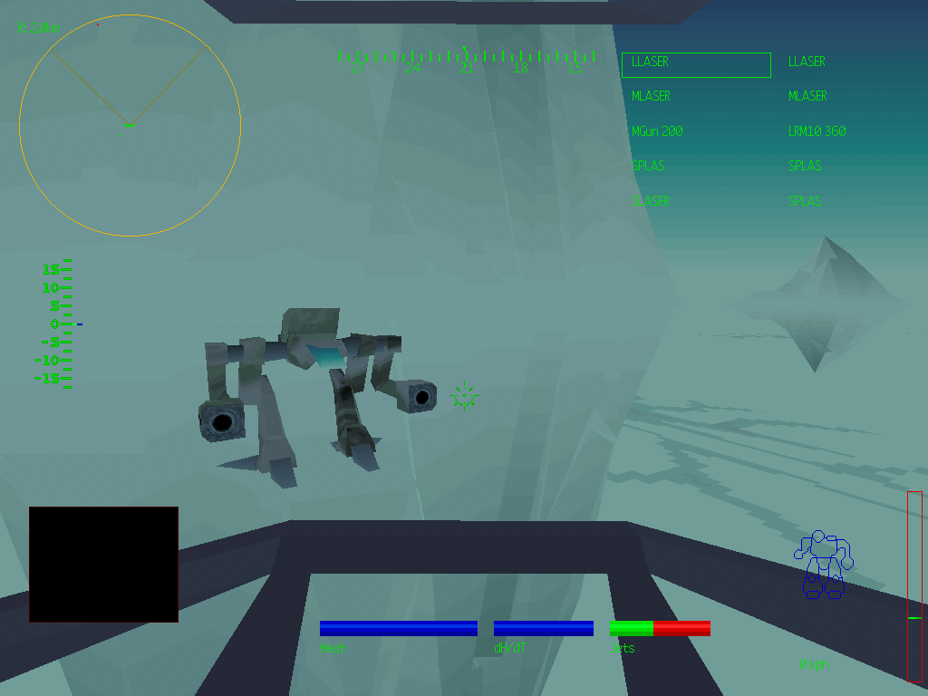

Here is the Stormcrow made of legs from a rear-view. ALL the limbs move up and down when moving!
Third mech, a Stormcrow made of legs, aka: "FOOTMONSTER"
(I was bored when I made that. Either that or there was an error.)

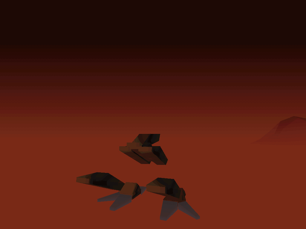

npsbre and I were to post pix of our netmech mod in this thread. I was helping him insert my TARJEN mod in his NET.PRJ, and we were testing the results. Here is my half:
That's what I saw on my screen. np said he just saw jenners. :?
