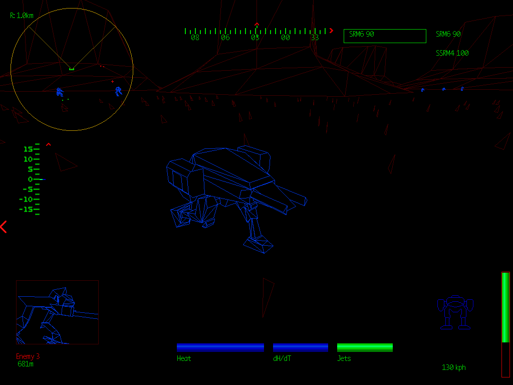

I've experemented with the PRJ a bit, and edited some mech chassis with just a hex editor (I used HexEdit 3.2), and look what I made!
:o
My first mech, a nova body and cockpit with a kitfox head.
:shock:

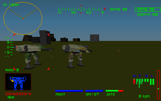

my second mech, a jenner body with a tarantula head. (you can't hit the cockpit because it is hidden inside the mech! So now you are somewhat safer.)

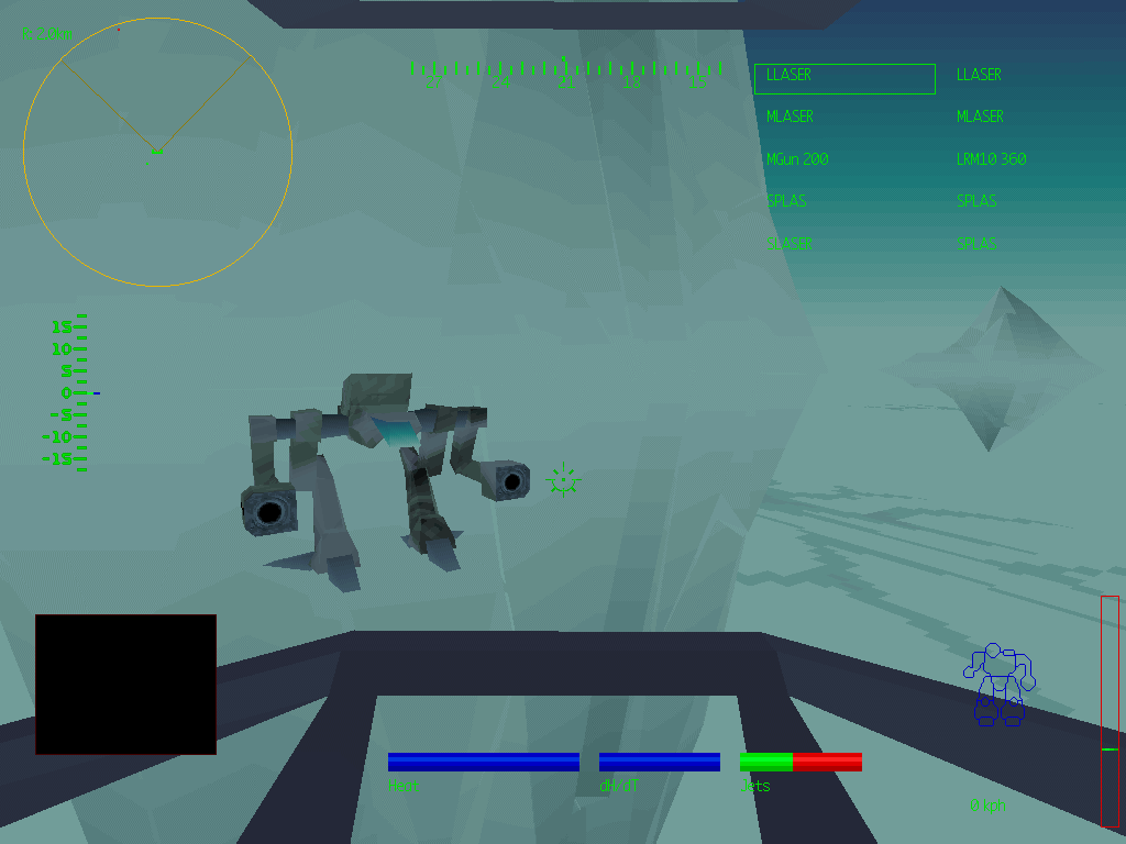

I Just found out how to do this recently, and so, I'm still new at this. I was able to add a Stone Rhino torso on a Direwolf, though, it looked a little glitchy and incomplete.
I would like to make some mechs into stuff like MBTs and aerotechs! If I can ever figure out what their .WTBs are named...
I also made a Stormcrow composed entirly out of legs, and when It walked, the whole body flailed around like crazy! Also, I made an Invisible Stormcrow! (But I guess there is no point in sending a picture of that :lol: )

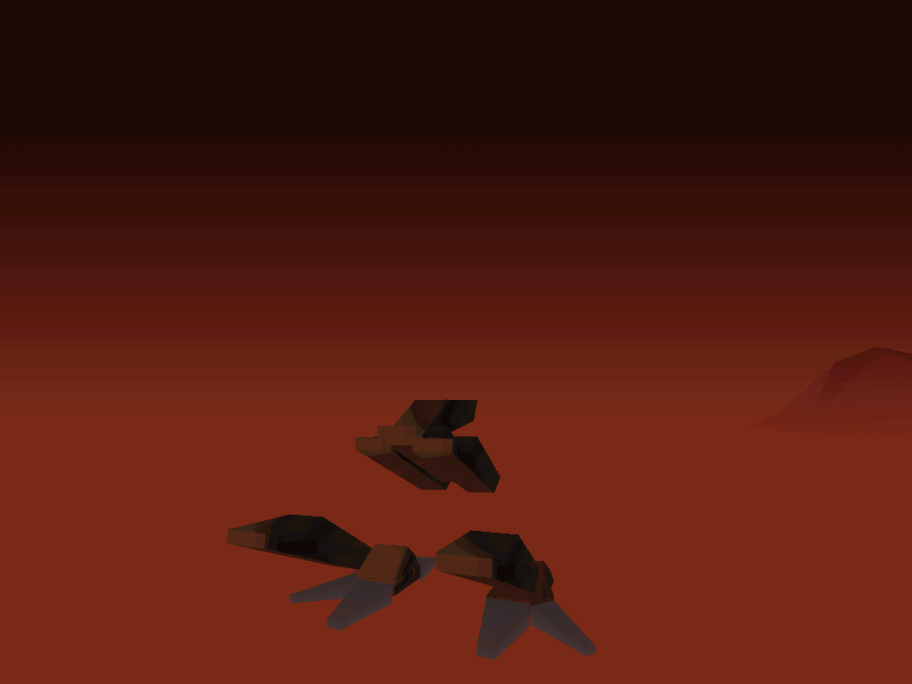

Here is the Stormcrow made of legs from a rear-view. ALL the limbs move up and down when moving!
Third mech, a Stormcrow made of legs, aka: "FOOTMONSTER"
(I was bored when I made that. Either that or there was an error.)

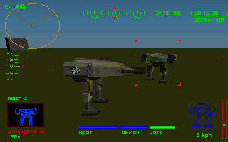

npsbre and I were to post pix of our netmech mod in this thread. I was helping him insert my TARJEN mod in his NET.PRJ, and we were testing the results. Here is my half:
That's what I saw on my screen. np said he just saw jenners. :?
