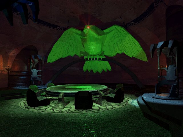

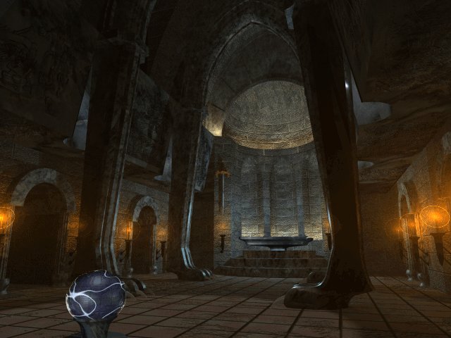

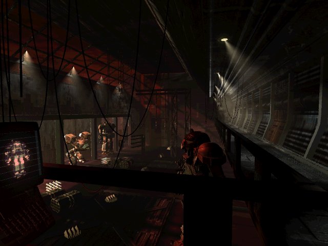

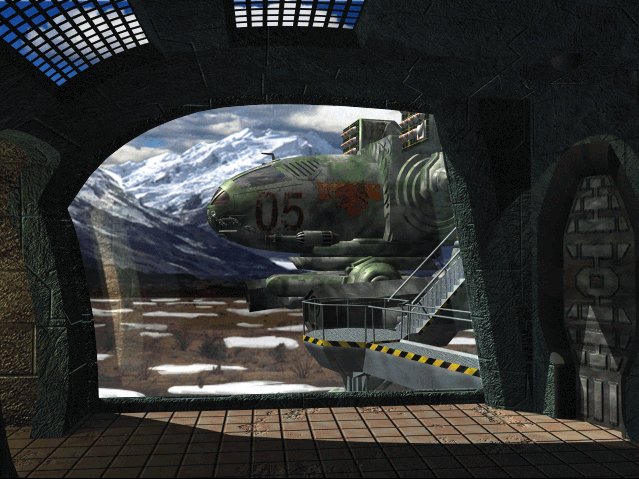

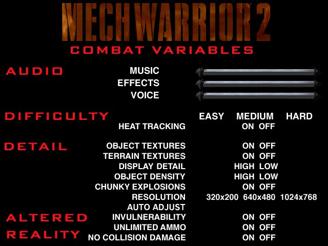

OK, here are the promised screenshots. The combat variables show settings as you won't see them in DosBox.
Once the screens decode correctly, I can start working on recreating the MW2 shell. The goal could be a stable version of MW2:Mercs, with salvage for the DOS version ...
- Mercenaries: Mech Hangar
- 13.jpg (42.14 KiB) Viewed 18659 times
- Clan Ghost Bear: Clan Hall
- 10.jpg (116.05 KiB) Viewed 18661 times
- Clan Jade Falcon Hall
- 17.jpg (52.78 KiB) Viewed 18661 times
- Clan Wolf Hall
- 10.jpg (50.14 KiB) Viewed 18660 times

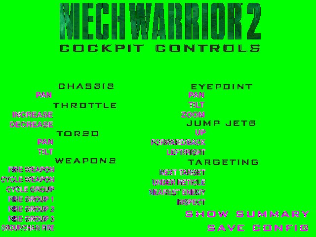

- An older version of control configuration? Does not decode correctly yet.
- 3.jpg (61.59 KiB) Viewed 18660 times
- Combat Variables with various settings in one image
- 2.jpg (56.45 KiB) Viewed 18661 times

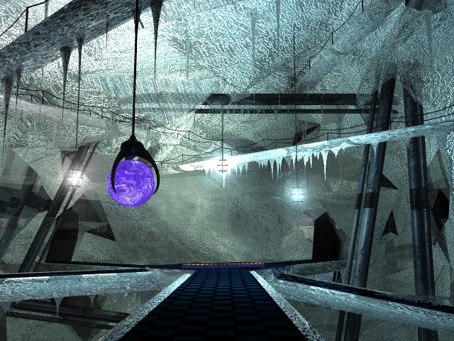

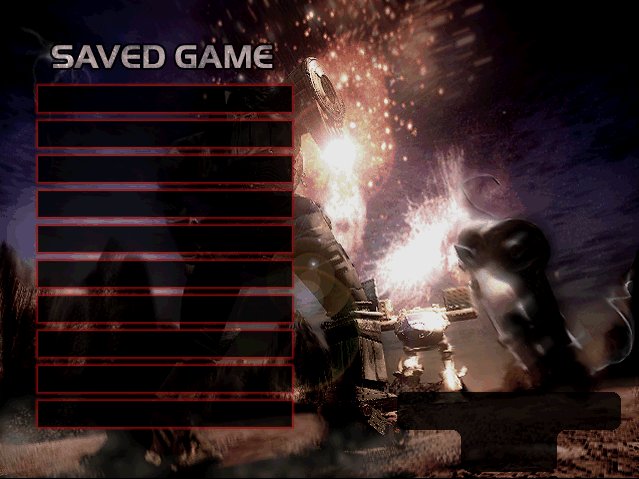

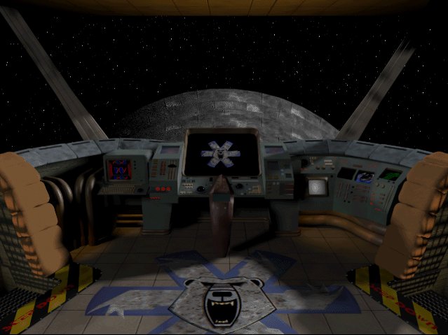

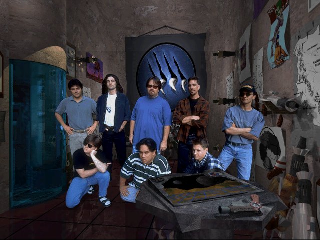

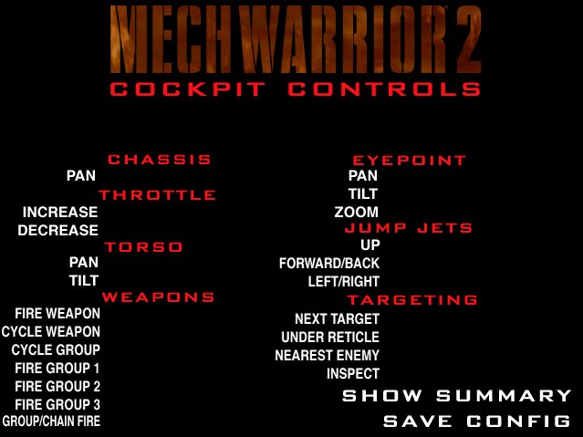

After a bit of code cleanup, everything works nicely. You may download the newest executables and source from mechvm.org and explore DataBase.MW2. The shell screens are listed with an extension of EFA, and can be viewed, exported, or replaced.
- Timby.jpg (76.94 KiB) Viewed 18617 times
- Mercs-load,save.jpg (58.48 KiB) Viewed 18614 times
- mercs-egg.jpg (72.37 KiB) Viewed 18615 times
- GBL-orbit.jpg (46.71 KiB) Viewed 18610 times
- GBl-egg.jpg (70.92 KiB) Viewed 18612 times
- cockpit controls.jpg (45.18 KiB) Viewed 18613 times
