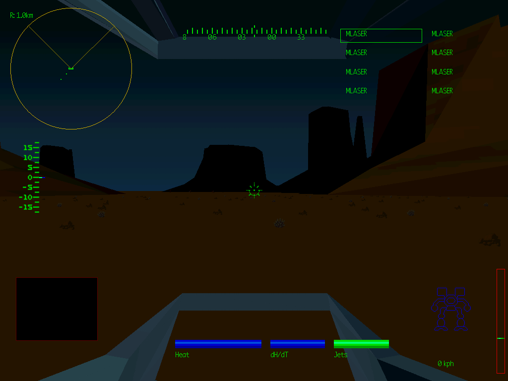

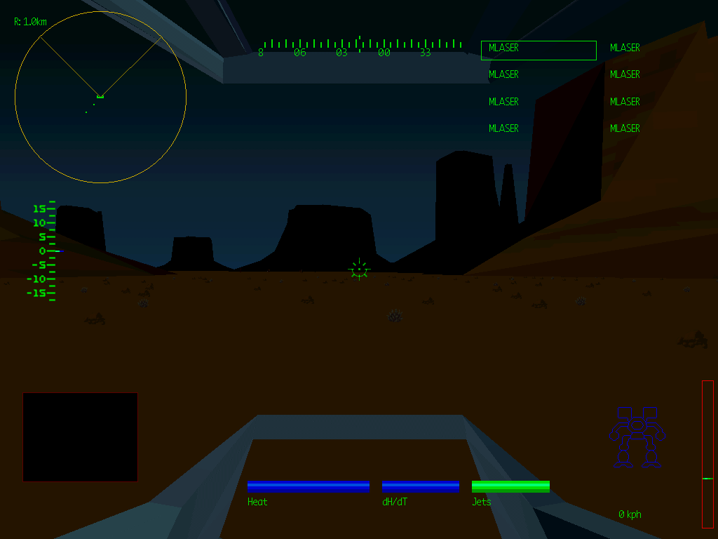

It does work on DOS as well Skyfaller; I am not sure why, because it is very similar to what i tried last night, but your patch hit all 73 occurances that I had and patched it perfectly.
I would note, as I said on Mektek: you may want to consider a slightly smaller value, there is a noticeable framerate decrease which might become painfully obvious in a comp that is say 1.7 ghz or something.
so, awesome development I would say!
Before
Before
After
After
