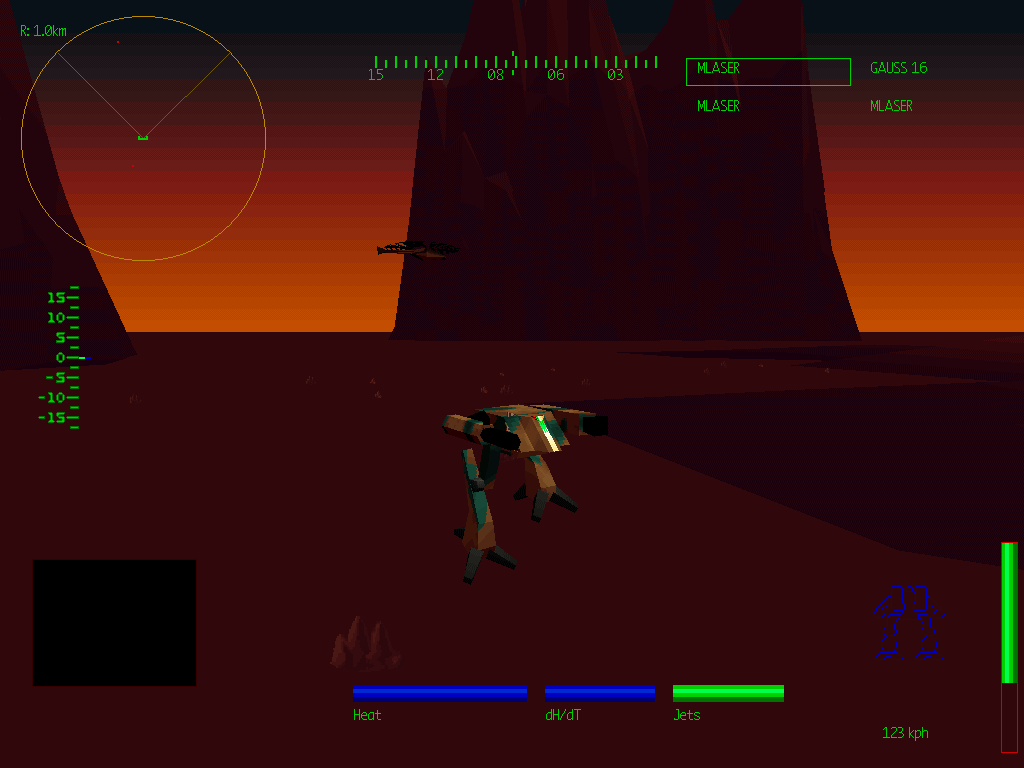

It works a little better now - I was able to add support for multiple textures. Here's what must be done to create new MW2 mech geometry:
- Create a 3D object with UV coordinates
- Export all polygons of a single body part that use the same texture as an OBJ file
- Use PRJPP's obj2wtb command to convert each OBJ to a WTB
- Use PRJPP's wtbjoin command to create a single WTB from several WTB's with different textures
- Create a new BWD or modify an existing one to use the WTB files
As you can see, minor some problems remain, but I think these can be dealt with. Use the attached package to replace Mad Dog with Shadowcat (highest LOD only). You may want to back up your files first ...

- MW2: Shadowcat
- mw2_000.png (23.81 KiB) Viewed 52222 times

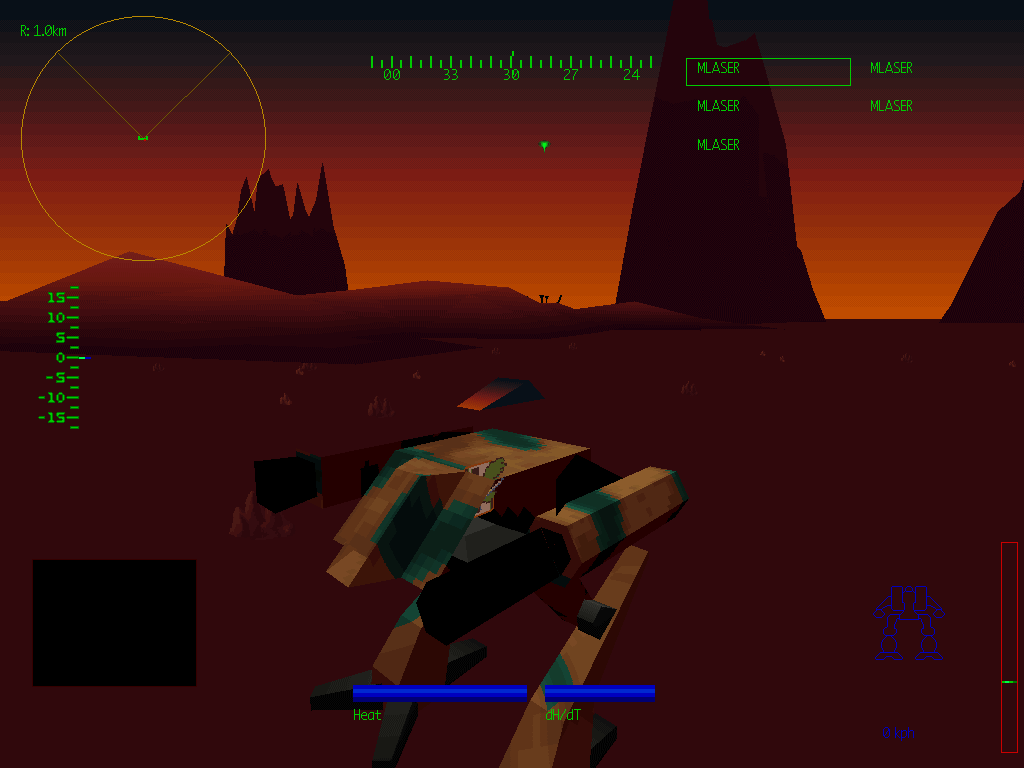

I have updated the Shadowcat: corrected the arms and added a windscreen, and added a special config 45t config that can be selected when choosing the Mad Dog in the Mech lab. However, it still needs work, mostly to make it compatible with the Mad Dog.
I wouldn't miss some of the lower level of detail for some of the mechs. Most mechs have 5 levels of detail, and I need want the highest. Following that logic, we could add four new mechs for every mech already in the game, improve graphics and reduce the need for CPU grabbing
Without your work on the WTB headers, it might not have happened.quota4stupid wrote:Btw, nice work Skyfaller - it looks freaking awesome mate
- Shadowcat with more corrections
- mw2_001.png (22.3 KiB) Viewed 52209 times
