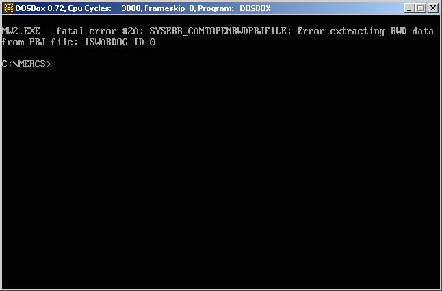

Gave Mercs a spin with one of the NAIS mechs:
Looks like we're crap out of luck :-( I put the ISWARDOG.BWD into the main Mercs directory, rolled a USERSTAR.BWD that named it with WASM, copied in some RMG BWD files I'd captured previously and ran mw2.exe from the prompt - and it crapped out. Looks like while it will look for certain BWD files in the main directory (including the SCN1 file) it WONT look for mech BWD files anywhere other than the project file. So much for that idea :-(
