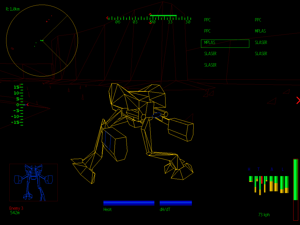

The Gargoyle gets a makeover...
Notice anything different here on Devin?

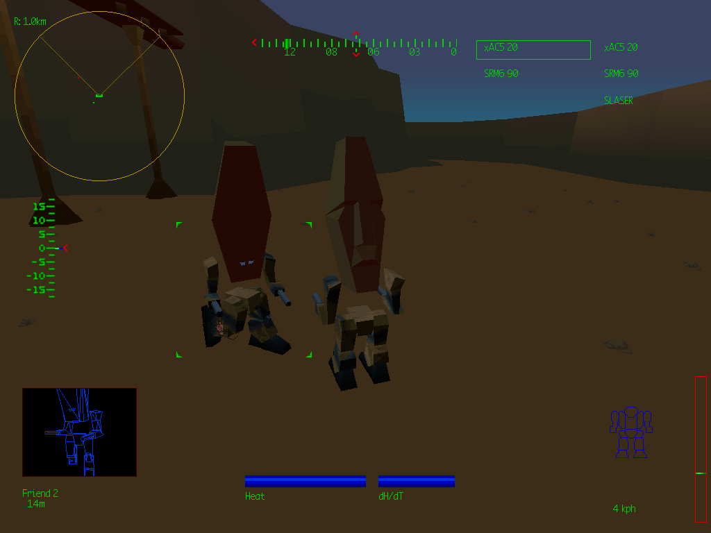

Really cool creations. What are the specs for your easter island mechs? MW2 clan mechs are lacking a 90 ton mech, I think. GBL has the Executioner, a 95-ton mech.
If you like, we could fix this mech to look perfectly normal, i.e. flip the face to front and place it firmly on the hips. Maybe we could even change the size of the head. Just post the mech .BWD or ask me how if want to do it yourself.
Re: Build-A-Mech
This is just an edited Gargoyle mech, I never really intended for this to be a new design until I saw some possibilities. The "Easter Island" heads, or "effigy" heads, they came from the Clan Wolf mission "Golden Spade" on planet Morges. I think I replaced GG1_HEAD.WTB with S_BESTRA.WTB. The Vista, which is the computer I run MechVM on, it is not always avalible to me, so I'll have to give you the .BWD some other time.

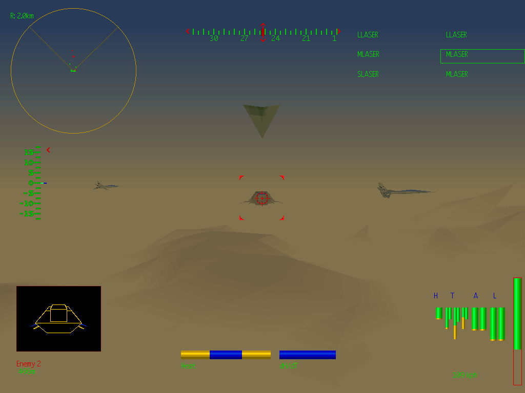

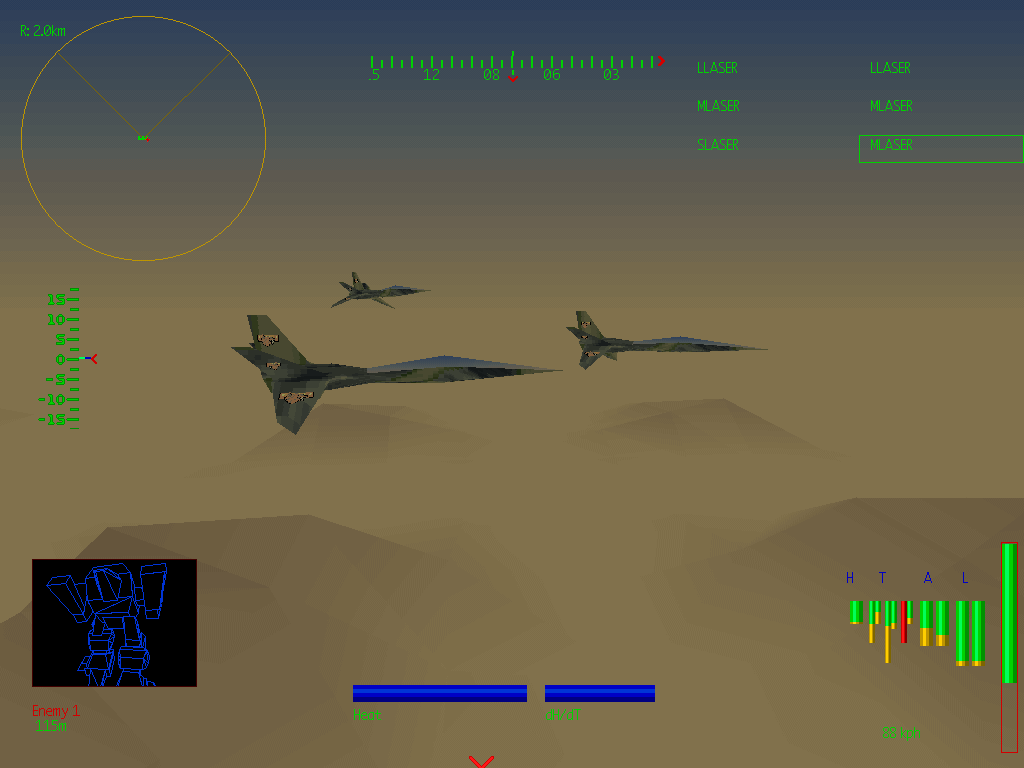

Look what I did by swapping around some .BWDs!
Cool, eh?
Re: Build-A-Mech
very nice aerotech fighters
Re: Build-A-Mech
This was probably one of my easiest mods.
What I did, was run MechVM, and replaced the Marauder's BWD with the DROPA.BWD to get the dropship. I replaced the Stormcrow's BWD with AIRCRAFTC.BWD to get those cool aerotechs! I replaced BWDs that were similar in memory size since the game acts all funny when they are two whole different sizes. I.E., replace a little file with a huge one.
Was that type of aerotech ever in the game other then when it was grounded? :?

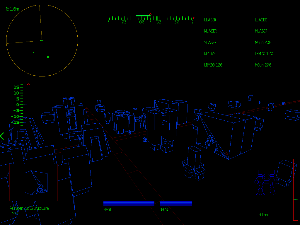

At the time I did not realize that the PRJ would react badly when MechVM replaced a file with a new file larger than the original. But the problem is that most Mercs chassis and limbs are much larger in data size then 31cc, but the Awesome head was actualy smaller than the Marauder head, so that worked out just fine.
There are also some pretty cool shipshapes, buildings, and other mechs and stuff that are in the Merc's PRJ that could be used in 31cc, that opens a whole new field of mod options! :D
