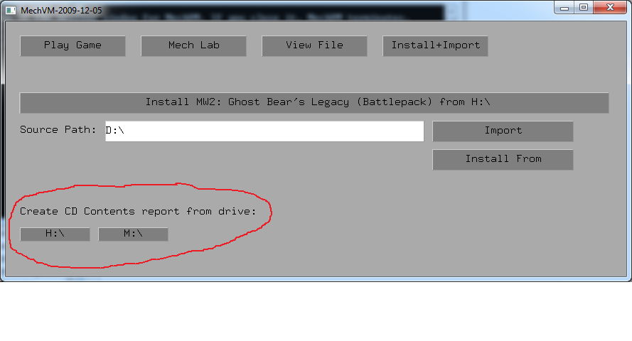

If the game was installed, but doesn't run, please post install-report.txt from the game's directory, <MechVM path>\games\<your game>. If MechVM does not offer to install it, use the report CD button, highlighted in the picture below.
