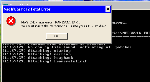

-For Windows XP Slug's Hook, I first installed Mercenaries the regular way. Then, loaded SH but it said it could not find any installations. So, I created the shortcut and was sure to include the proper arguments after the file path. Game loads even better; intro video was good and I could successfully navigate the campaign rooms (terminal, contract database, etc). However, launching any mission resulted in another crash with the same fatal error message saying my CD-Rom was not mounted. Instant Action does the same thing.

In conclusion, Slug's Hook seemed to deliver the best result, but the fatal error seems impossible to solve. I don't see how it could possibly fail to detect the disk when it was used to install and appears in the D drive when going into My Computer. I should also mention I did all of this BEFORE trying to patch to 1.1 and then patched first just to see if it changed. Nothing works.

EDIT: Screenshot of the issue attached.
