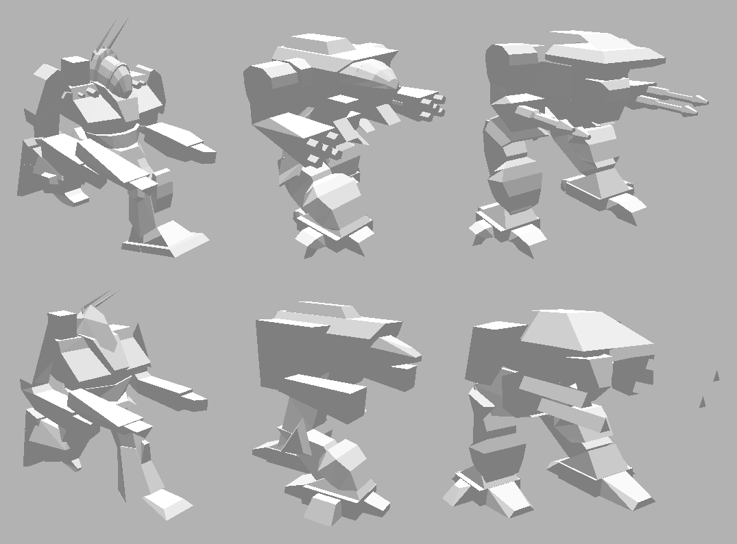

This is what the mechs look like when importing from the 3DFX version. They look much better than the simple ones in the DOS version. See for yourself, guess which is which.
- 3dfx vs dos.png (51.85 KiB) Viewed 14741 times

Re: ATI-Rage Edition geometry
But ignoring file replacement size, what is it that is preventing the ATi PRJ from running in place of an ordinary PRJ?
Excelent work, Sky!
The problem is that the 3D enhanced versions use a different format that DOS cannot understand. While it would be possible to convert that format, I don't know texturing works in MW2.Col.Kell wrote:But ignoring file replacement size, what is it that is preventing the ATi PRJ from running in place of an ordinary PRJ?
