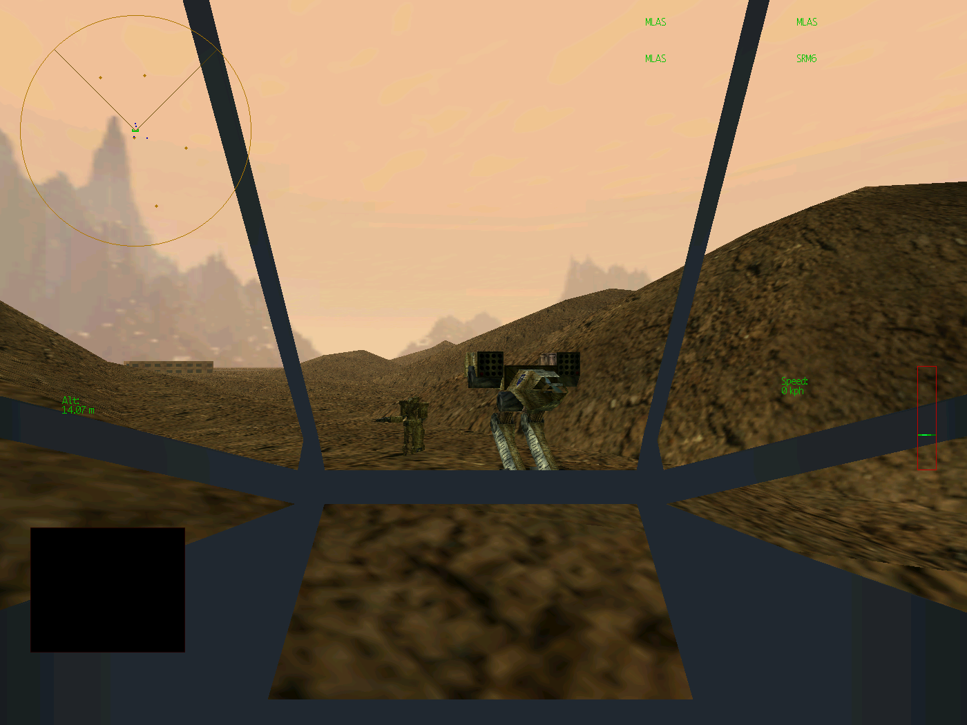

Test the patched DLL cautiously. Close all other programs before using the patched MW2. I have seen it cause Windows XP to reboot. Use at your own risk, DOS is best for testing it. It is a work in progress.
However, it works if you need 800x600 on an old display.

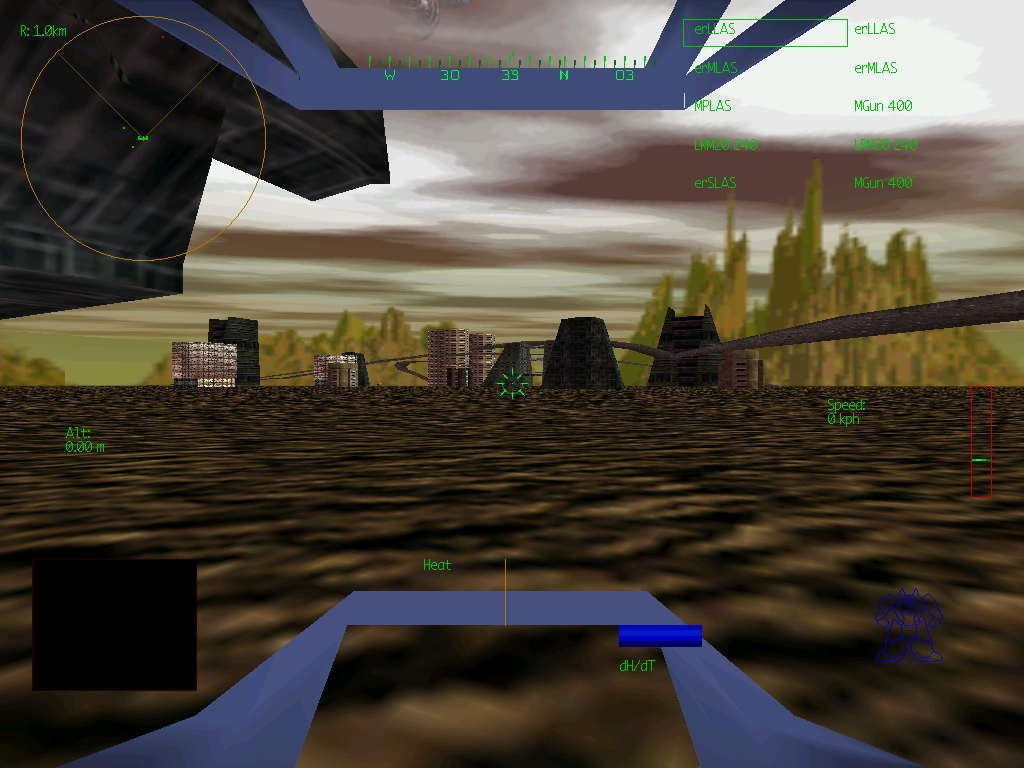

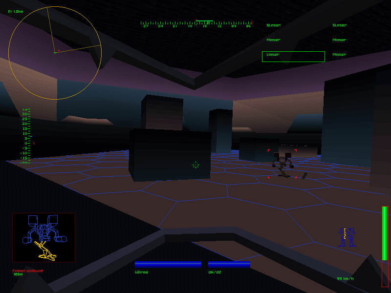

More importantly, I tried to create a similar mod for Titanium Trilogy: GBL. I got a little further, I've tested resolutions 800x600, 1024x768 and 1400x1050 successfully. The catch: the mech target display must be deactivated by pressing F4 twice first, or the screen gets messed up. I have not witnessed bad crashes. 3DFX is not needed for this.
You can create a patched MercsW.DLL by placing the resolution patcher below in you Titanium Trilogy: GBL folder. Run it there to select your favourite simulation resolution.

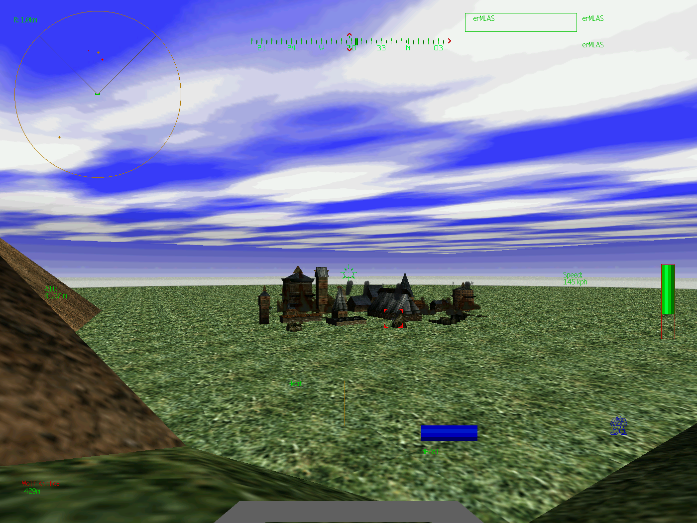

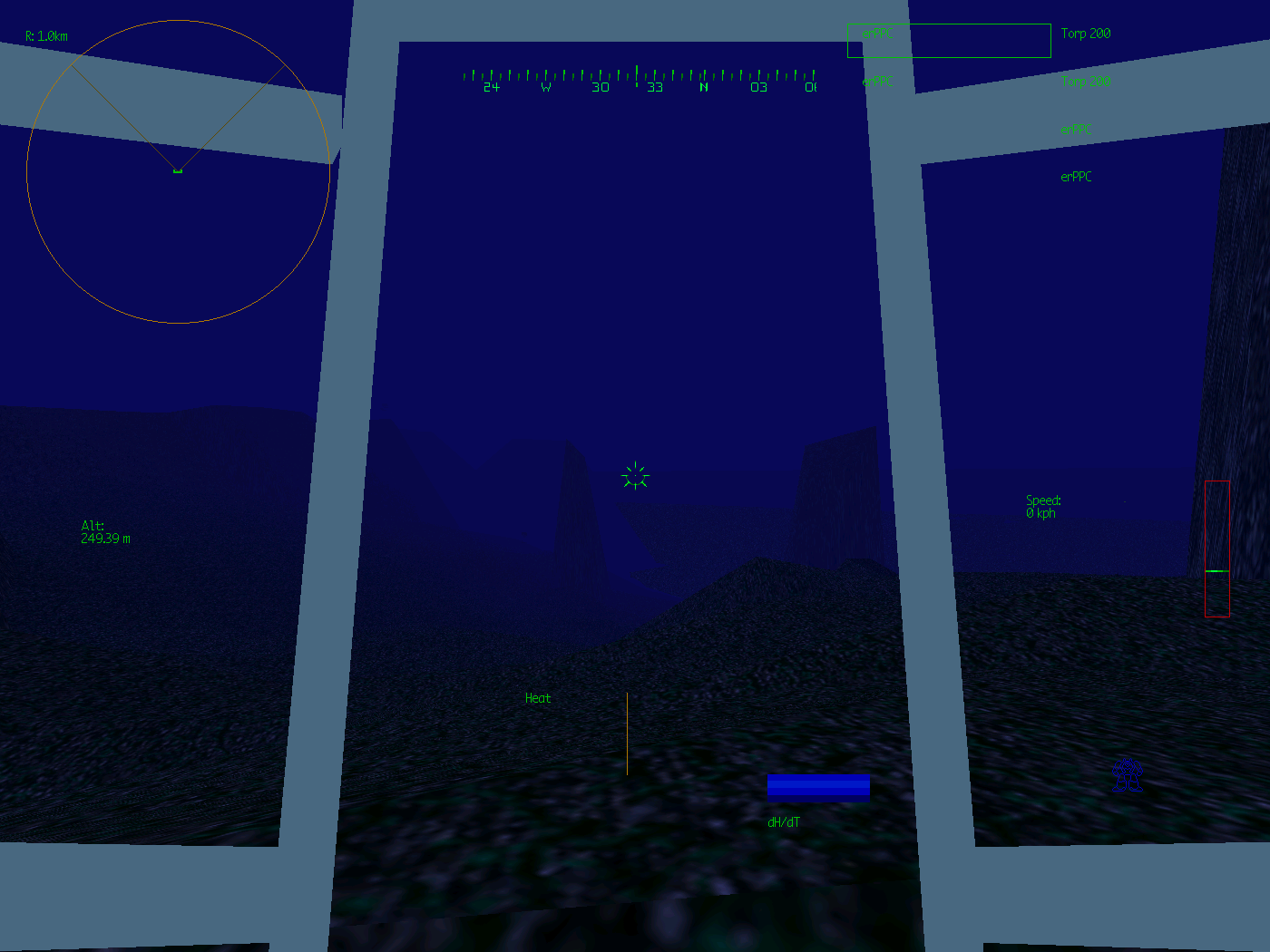

- Titanium GBL: Underwater Strike, 1400x1050
- GBL-Underwater-1400x1050.png (396.1 KiB) Viewed 17620 times
- Titanium GBL: Moritz, 1024x768
- GBL-Moritz-TT-1024x768.png (297.26 KiB) Viewed 17621 times
- Titanium GBL: Circle of Equals, 800x600
- GBL-Circle of Equals-TT-800x600.png (129.42 KiB) Viewed 17620 times

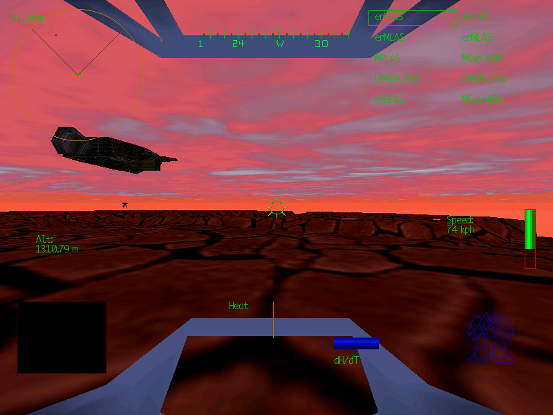

Better news on MW2:31stCC Titanium, the GBL Titanium resolution patcher works exactly as for GBL.
- MW2:31st Century Combat Titanium patched to 1400x1024 without 3DFX
- realMW2Win 2008-07-03 07-45-21-58.png (755.6 KiB) Viewed 17610 times

those skys look so good and so bad at the same time:)
compared to what we have to day, they are horrible, but still pretty
and thinking back to what we had back in 96, they look amazing:P
